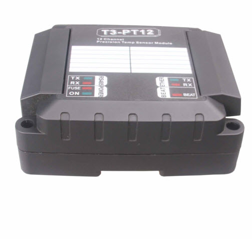

Precision Pt Temperature Sensor Module
The T3E-PT12 is a precision temperature measurement module which can accept up to twelve instrument grade sensors.
  • Instrument-Grade Sensing: Delivers high-precision temperature sensing with 0.4°C accuracy across the entire range.
  • Dual IP Protocols: The Ethernet port supports both BACnet IP and Modbus IP protocols for modern networking.

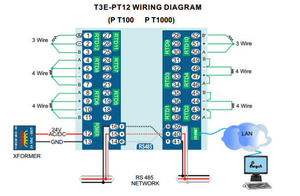

  • Flexible Wiring: Sensor inputs support 2, 3, and 4-wire connections to meet various accuracy and distance needs.
  • High-Speed Serial Comms: The RS485 port supports BACnet MSTP and Modbus RTU protocols at speeds up to 115.2k baud.

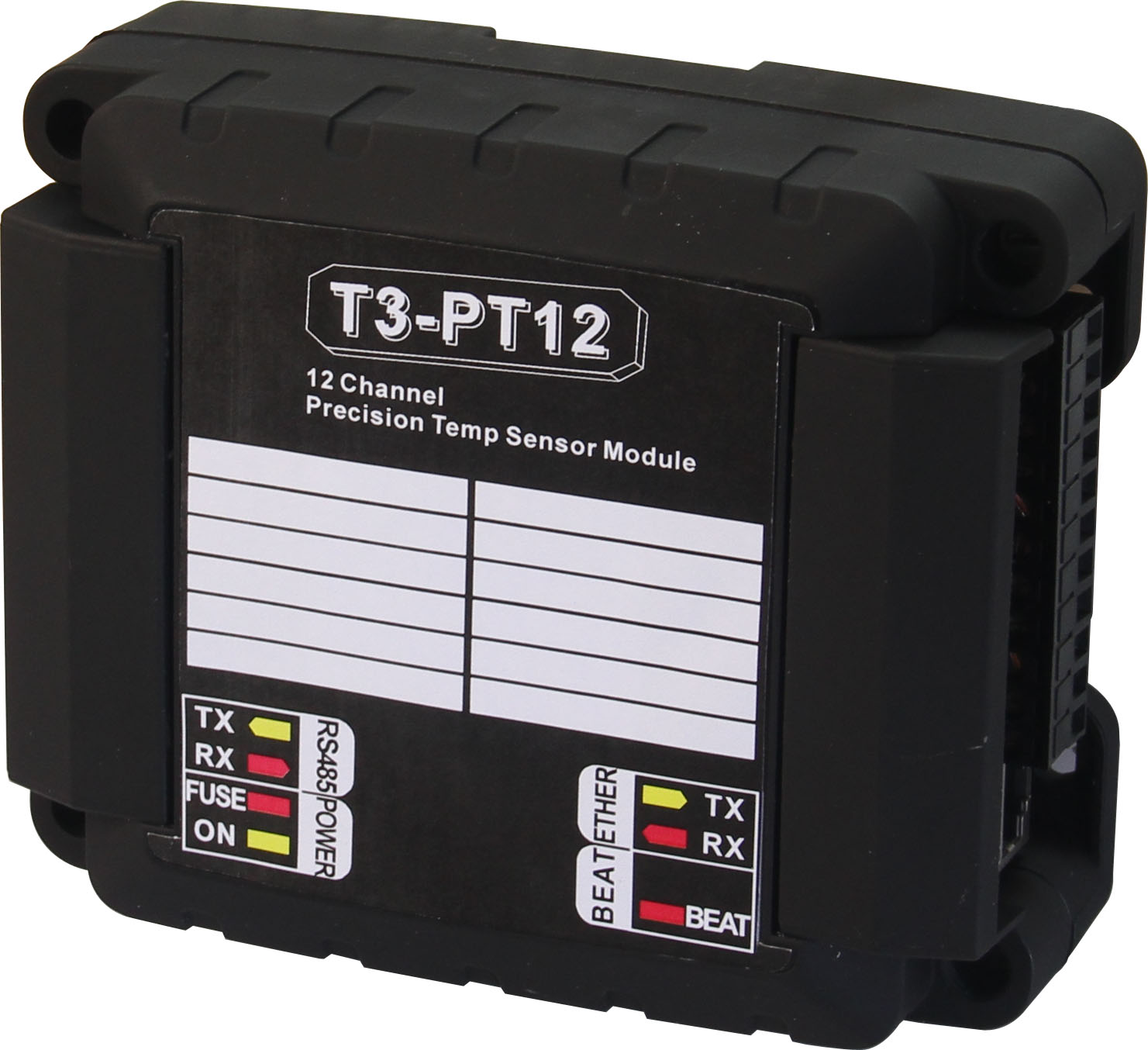

  • Premium Enclosure: A UL-listed ABS enclosure with a rubberized texture provides a high-end feel and durable protection.
  • Simplified Troubleshooting: The RS485 port features separate upstream and downstream connectors to make network diagnostics easier.

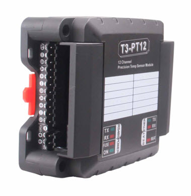

  • Pluggable Terminals: Each sensor connects to an individual pluggable terminal block for easy swapping and maintenance.

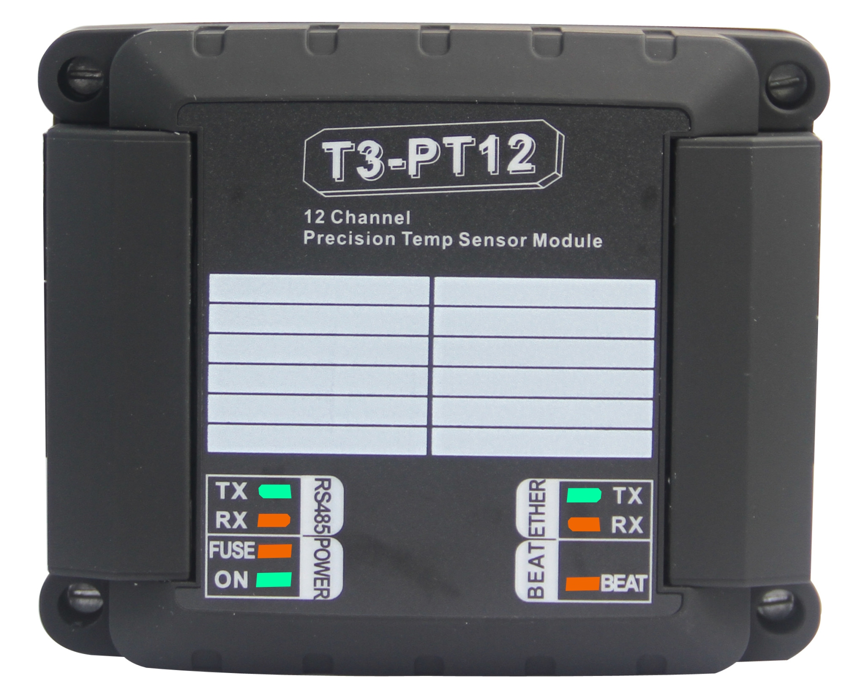

  • Easy Identification: A writable label on the front cover allows you to identify each sensor channel clearly.
  • Status Indicators: Dedicated LEDs show power, heartbeat, fuse status, and communication activity on all ports.
  • Open Source Control: License-free, open-source software allows you to set all parameters and read temperatures easily.

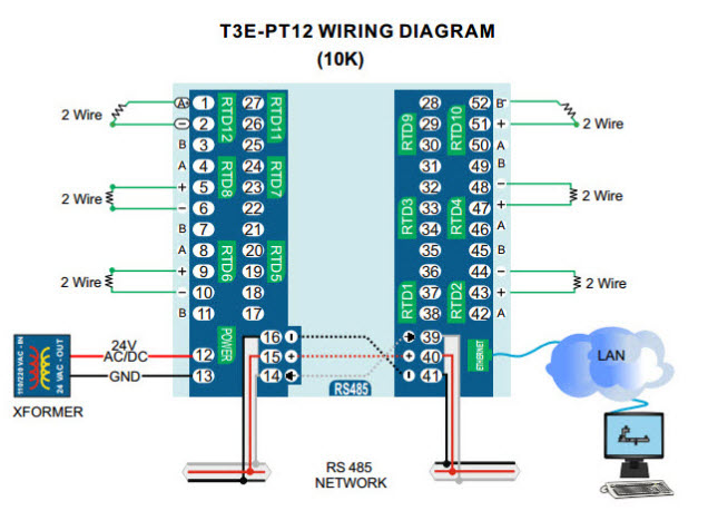

The unit accepts platinum Pt elements in both 100-ohm and 1k-ohm varieties. It also supports 10k Type II and Type III thermistors. You can complete the cabling using two, three, or four-wire connections. The module supports communication over BACnet and Modbus via both the RS485 and Ethernet ports. All readings and settings remain available as BACnet objects and Modbus registers. Each sensor connects to a pluggable terminal block, allowing you to connect or disconnect sensors without disturbing adjacent connections.
The module provides twelve sensor channels. You can wire these sensors with three or four-wire connections to achieve instrument-grade readings over long distances. For shorter distances where accuracy is less critical, a standard two-wire connection works well for many applications. Please note that due to space limitations, channels 9 through 12 support up to three wires, while channels 1 through 8 accommodate 2, 3, or 4-wire connections.
The RS485 interface features two separate terminal blocks to simplify troubleshooting. Although these blocks share the same internal RS485 port, this design allows you to easily separate the network during commissioning. You can power the device using any convenient 12V to 24V AC or DC supply. The internal power supply utilizes half-wave rectification, enabling several devices to share the same transformer. Finally, a self-resetting fuse protects the unit against ground loops and over-voltage conditions.
Wiring Diagram

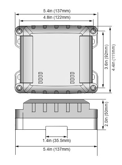

Dimensions:
